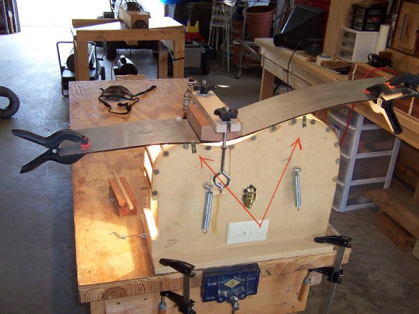

I attached a couple of metal tabs on the side of my bender. This allows me to butt the straight top edge up against them to keep the sides straight.

Also, like BobC said. I have tabs on each side of the bender to keep the "sandwich" lined up. You just have to remember to line one side on the left of the bender and the other on the right of the bender. I've bent 8 sides, pre cut & tapered, this way and have no problem keeping things straight. Works great.

I'm having trouble visualizing the tabs you guys are talking about. Can you post a photo please? Sounds like a good solution to the alignment problem.
PostPosted: Thu Mar 29, 2007 2:30 pm
[QUOTE=BarryDaniels] I'm having trouble visualizing the tabs you guys are talking about. Can you post a photo please? Sounds like a good solution to the alignment problem.[/QUOTE]
Barry, here's a pic of my bender:

Ron, Thanks for the pic.
